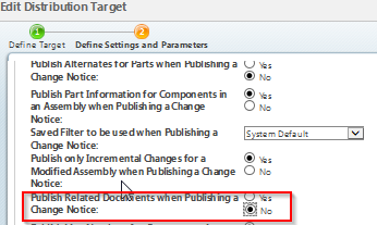

For ECN centric, The OOTB preference for this is esiTarget specific
Without the ECN, the setting is controlled via Site/Preferences. Under ESI,Settings, Document
