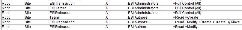

Jul 20, 2016 2:46 PM UTC
Not sure if this would help.
remove Read access to ESIRelease for ESI Authors group (but not ESI Admin). Then add
for ESI Authors.
The ESI Closeloop witll hang at "Post Release" and then complete.
ESI does complete.
