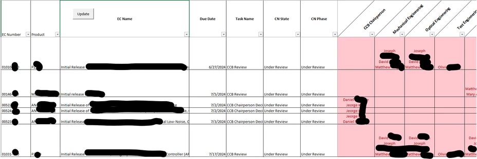

Its possible in Excel for sure. This is processed from the Open Tasks report into Excel showing signoffs pending and who needs to sign. For Power BI, I think you can do it if you can suck in the QML report. I do this in Excel from a web query.

Absolutely you can extract and load data to Excel via PowerQuery.  I do the same and also with PowerBI.  Depending on desired user interaction level with the data it can be more of a data warehouse approach with periodic refreshes or a much more discreet scope and use-case for ad-hoc data pulls.
The statement from the OP that I focused on was "if i type a CT number into a cell, the cells adjacent to it will feedback data about that CT".  If looking to type into a cell and pull real time info from Windchill that's different than pulling a data set into PowerQuery, loading as table, then typing the CT number into a cell and returning info with lookups.  The request needs a little more clarity to understand what is trying to be achieved because there are multiple approaches.  Is it a requirement that Excel be used? Is it a requirement that Windchill not be the UI tool to perform the search/report?
