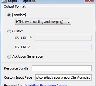

We are currently in the process moving from WC9.1 to WC10.1. We currently have many Windchill reports, created in report builder which we view and post process in Excel, using web query. In WC10.1 the reports generated are no longer pure HTML. It would appear this now stops us using web queries in Excel.

Query Builder Reports were one of the thing that we poured the most effort into during our upgrade preparation, going from 9.1 to 10.1 recently.
Many, many things need to be addressed.
In general, the Reports run in 10.1 from the Windchill GUI, but accessing them from Excel requires updating the URL inside the macro at a minimum.
Note: Legacy mode will likely not affect how they run.
One can disable the 10.x UI for query builder reports by applying this text as needed.
Custom Input Page: wtcore\jsp\report\reportGenForm.jsp
[cid:image001.png@01CE94D9.F59611B0]
Aug 12, 2013 11:15 AM UTC
Cheers Mike, setting custom page works a treat, thanks for the tip. Looks like I've got my Excel reports back.
