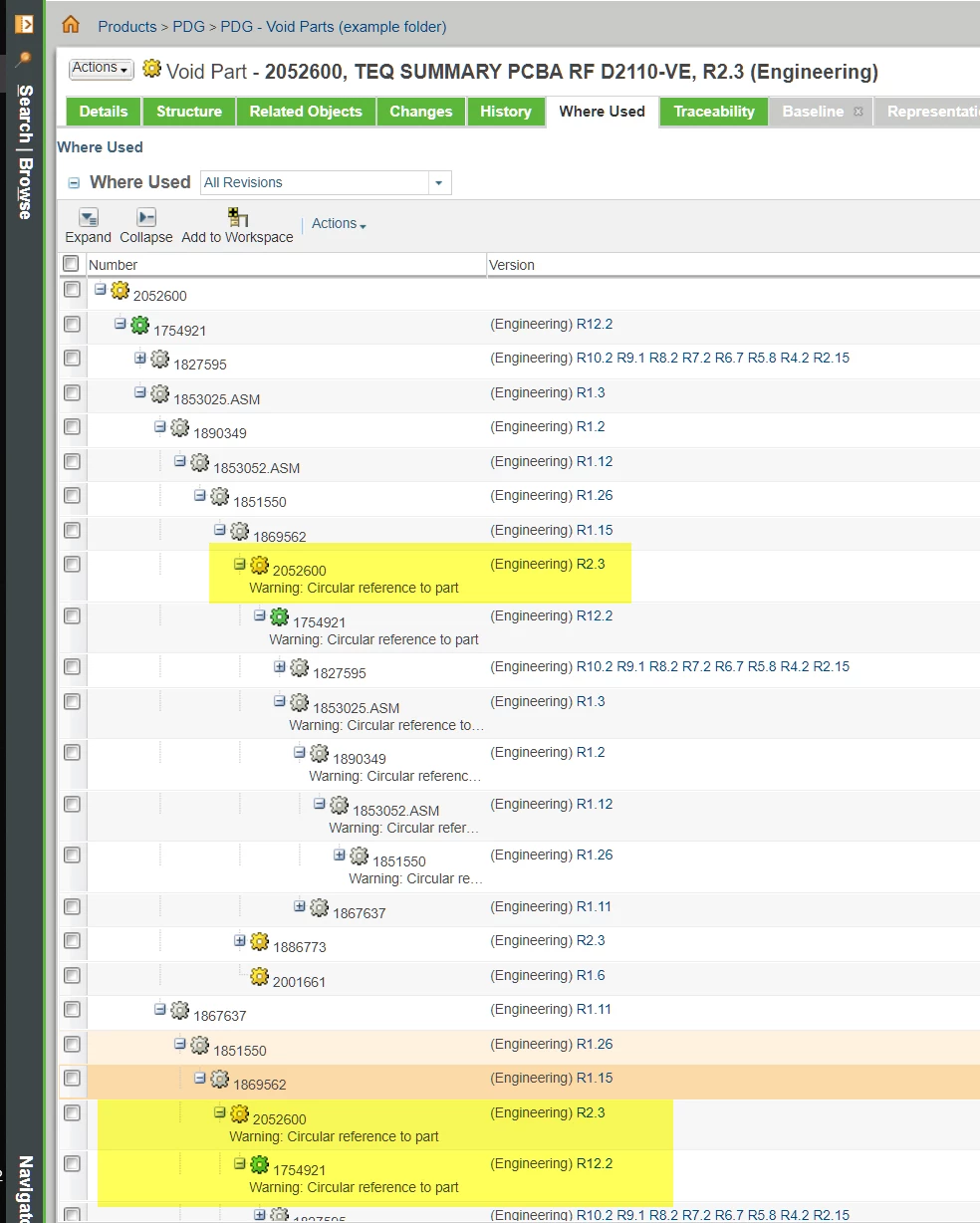

  • "Where used" analize would also fails (see the attached screenshot)
