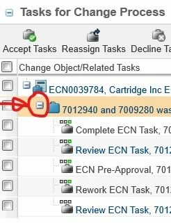

Has anyone figured out how to get the tables to expand by default?  I look at the Tasks for Change Process on CN's quite a bit and it's annoying to have to expand them every time I open a CN.  It would be nice for each user to have the option to expand everything or specific tables.

SteveG, what version and CPS of Windchill are you on?  You may want to open a Support case to inquire about this, as I suspect there may be a way to help do this, in newer versions of Windchill, with some properties and/or customization?
wt.change2.changeWorkItems.tree.isFullExpand seems relevant, for example.
I personally don't know too much about this, but you should be able to get some more info via a Support case, with one of the engineers.

Well, the setting wt.change2.changeWortItems.tree.isFullExpand set to true worked. We tested on the test server first. Now it's on both test and production.
