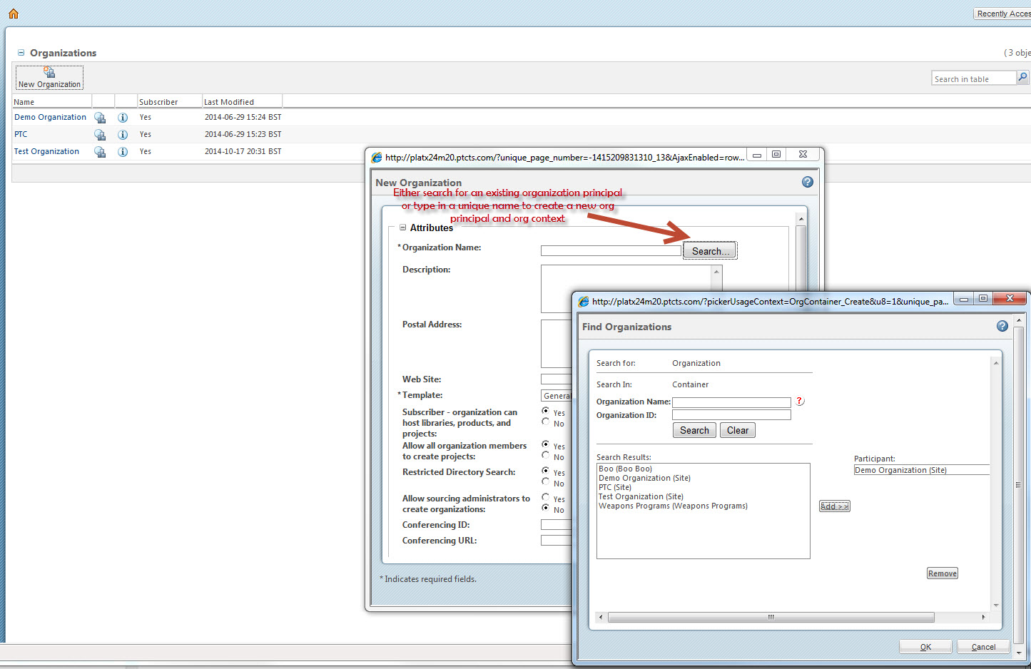

Organization Principals (or Organization Participants) are Windchill objects that represent an organization object in the LDAP (e.g. o=PTC). You can create them in two ways:
1. Site > Utilities > Participant Administration > New Organization (Note: this does not create an organization context. Organization contexts are the objects to which Products, Libraries, and Projects are associated.)
2. Navigation bar > Browse tab > Organizations > View All > New Organization
This is where you create an organization context. You can either create a new organization context and principal by specifying a unique name for Organization Name, or you can search for existing organization principals and create a new organization context associated with that principal (Note: only one org context can be associated with an org principal).
