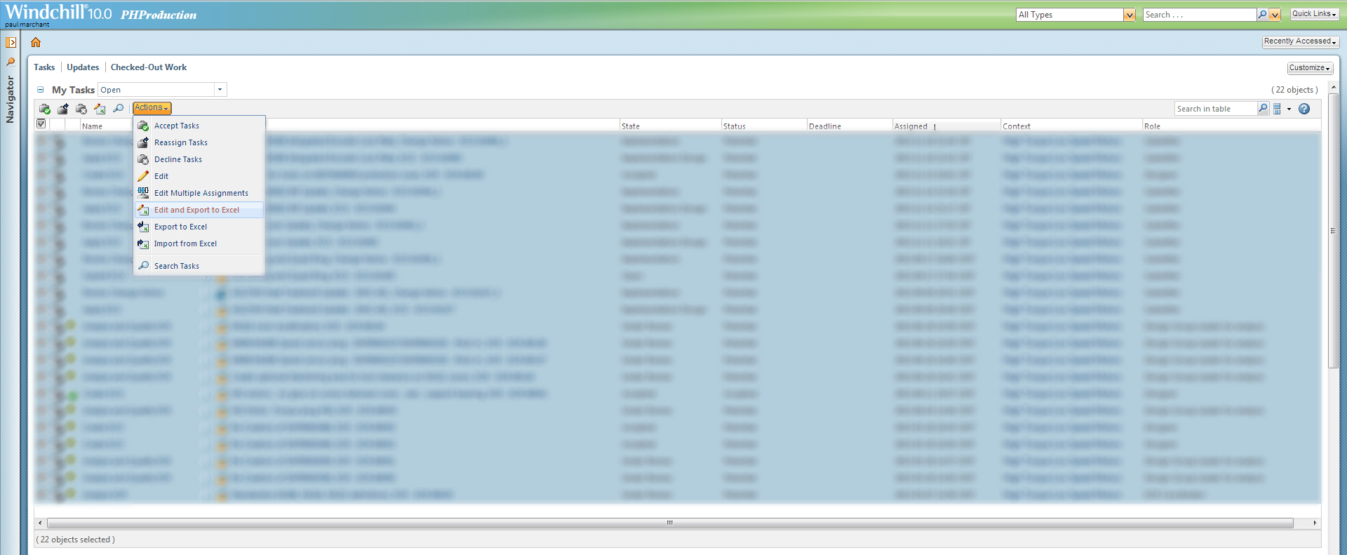

Exporting "My Tasks"
I have the option to export my tasks to excel but, when i do, all i get is an excel file with the headers but no tasks listed. Can anyone explain how to export tasks?
Nov 21, 2013 5:58 PM UTC
According to the help topic that describes actions on the Tasks table, when you choose Edit and Export to Excel, as shown in the screen capture above, only the tasks for which you have modify privileges will be included in the spreadsheet. If you select Export to Excel, all action items displayed are available for download. Does that information help to address your question?

Unfortunetly, Edit and Export to Excel and Export to Excel result in the same thing.
Nov 21, 2013 6:25 PM UTC
These actions are only supported with create and edit of Action Items.
