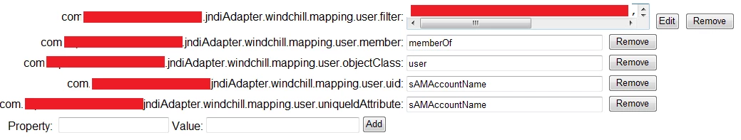

We have achieved filtering of the user login by creating a group in AD for users, only which should have access to windchill.
Then the JNDI adapter is used to map this group only. So the users in AD outside this group can not login to Windchill.
