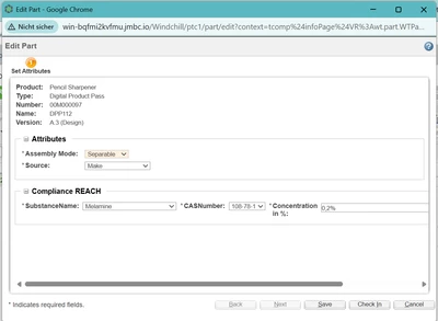

I am trying to learn on external enum value list, need some Help with an example I'm working on. Trying to create an Attribute with a material of high concern and a propriate CAS number when I edit a WTPart, I've managed it with Global Enum and I want to explore it with External Enum value list
I've done it so far with Global Enums as a dropdown menu i select Substance Name and CAS number is selected automatically when i edit the part

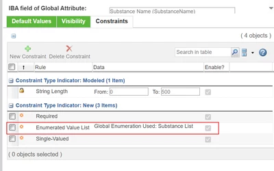

In the Manage Types I ve created reuired Attributes like Substance Name and the CAS number and put in an Enumareted Value List
further in the cascading attributes i Ve created a rule where each substance is connected to its proper CAS number, that is no problem when it is few relations but exhausting when you have 500 substances so I'm thinking to do it with External Enumerated value list where i just create a xml file with the proper substances and CAS numbers which can be later easly edited

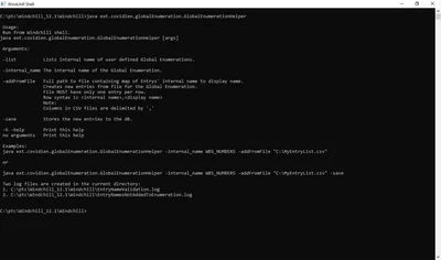

@EC_10581209 , I think your best bet is to write a utility where you can add values to the Global Enumeration from a file.
I looked in my toolbox and found a few classes I'd written in 2016 for a company to do just that.
I recall them using it to populate enumerations.  It's bombproof.
I also recall figuring this out was not simple.  There's quite a bit going on under the hood.
You can either list all existing Global Enumerations
or
You can specify the Global Enumeration and a file (cvs or text) containing the values to add to the enumeration.
You can run in test mode too which does NOT store values to the dB or in save mode which will store values to the dB.
The help looks like this.
