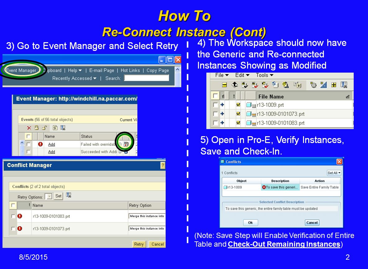

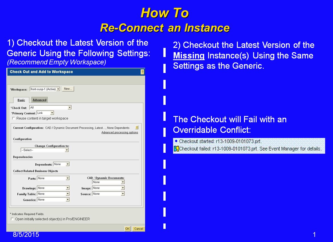

Two things to try.  In both cases get you reset to what version 1.8 represents with all instances residing in the file.
1) Delete version 1.9 out of Windchill
2) Reconnect process (see images)
