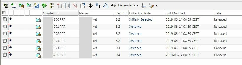

We have a user who has revised instances so that the latest generic is incompatible with some latest instances.

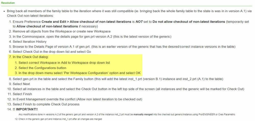

I was trying to use the following article https://www.ptc.com/en/support/article/CS128366 I can't find the option 'Per Workspace Configuration' described in the article. Note, I don't want to revise all objects as it would include an ECN and sending out new drawings to the supplier.

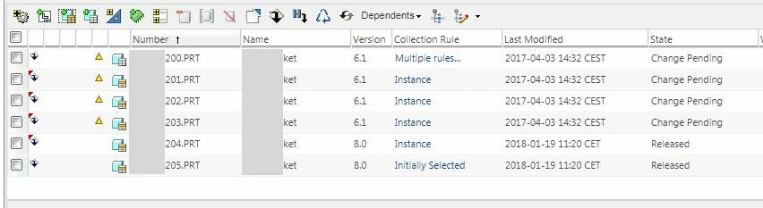

Anyone who have used the process in the article or have another solution for aligning the latest generic with all latest instances?
