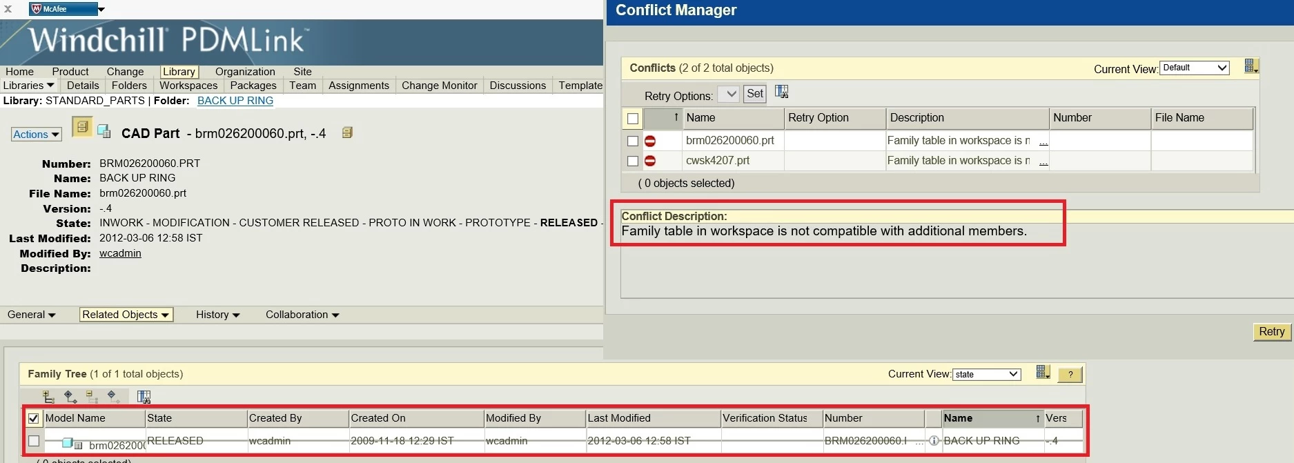

Dec 20, 2017 6:01 AM UTC
Could you please share the Family tree report genration script ..  I want to use for analysis ..
Let me describe mt problem ..
We have consolidated two instances of same versioned Windchill system into one..
Now we are observing some issues with Family table.
For doing this, we have used custom method to load metadata & Content and then creting links for those loaded metadata.
But the present situation is that we are facing problem with FT objects.
-   For genric part,  member in Family Table tree is crossed ( atatched the screen shot )
-  For Instances,  Family Table is not getting populated.
I am looking for cause for this, then only I can able to understand which step of migration went wrong or which has to be repeated to correct it.
advise related to this would be very helpful in proceding furthur ..  we are actually stuck at this point ..
