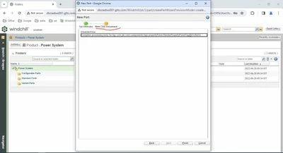

When i tried to create Cad document using WT part, it is showing following error:

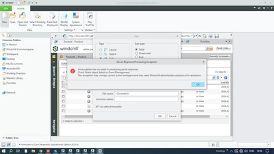

Similarly in Creo Integration:

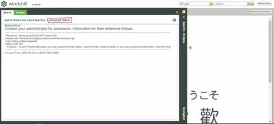

Advanced search:
