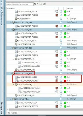

I have a question about fiability in structure tab. I use "show document" with standard action

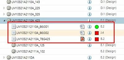

On a part, I have 3 described documents attach on it.
See below :(same documents on associated objects)
But
in a nomenclature with this part attached, I do the same action (show document) on all structure, Only 2 documents are displayed !!
It's very critical to not have the good information here. someone already had the trouble ?

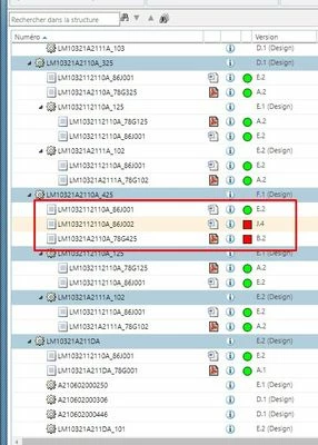

And last test, if in the structure, I show/hide documents of
the specific part it works and after I show document of the entire structure in the case it works....
Very Strange ?
