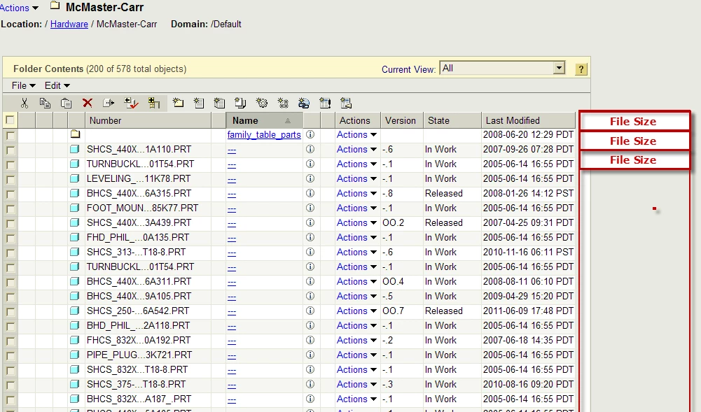

Gurus,
How do I add file size to a customized view?
My goal is to view the file size of each file.
Windchill 9.0 Datecode m030
Eric
22-Sapphire I
July 29, 2011
Not available via search but a can be included in a query builder report. Relatively complex set of objects:
- Document or EPMDocument
- Application Data, joined to Document using Holder to Content association
- Fv Item, joined to Application Data via Stream Data association
Sample report for WTDocs attached
