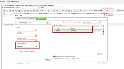

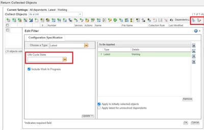

Filter by lifecycle state when collecting objects
Is it possible to, for example, when collecting dependent objects for release, to filter out objects that are already released?
HelesicPetr
Jan 14, 2022 9:23 AM UTC
Hello @rhart ,
In collection, try to use Filter.
Change table Affected example
Promotion Request example
Hope this can help.
Best Regards
PetrH
