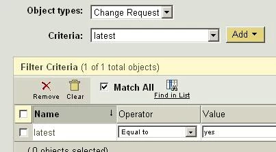

We have a number of users who have many objects in process at any one time (e.g. Change Requests, Work Requests, etc.). We also universally utilize Revisions (preference: Tracking=yes) for change objects. These users have a desire to have various methods for conveniently seeing all of their "work in process."
OTB, the Home, Updates table, along withmany other Tables, does not include Latest Revision as a selectable filter (via Customize View). We recently learned how to add Revision=Latestsfrom PTC, and just implemented in production last night; key users are now delighted.
OTB behavior example:
Filterresult set by specified state (and any other criteria), then find for each the latest Revision not at Resolved. With revisioning enabled for change objects, this returns many objects that are "abandoned" and not of interest. The latest Revision is often Resolved.
With customization available and applied by user:
Filter by latest Revision FIRST, then apply all other criteria. This returns exactly the result set of interest.

Please see attached file.
Just have to add
<attribute id="latest"/">
Result available everywhere (latest). Need to set to yes in criteria. It is evaluated first even if added after other criteria.
