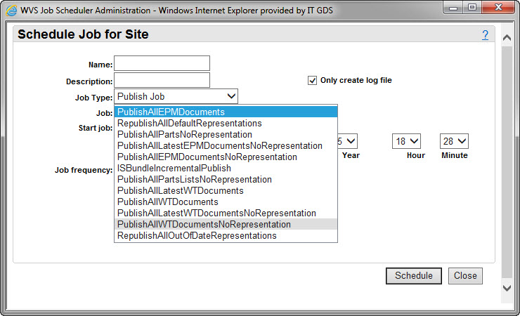

Sep 9, 2015 6:30 PM UTC
Hi, could you do this by generating the log file under Site, Utilities, WVS Job Scheduler Administration?
TomU
Sep 9, 2015 6:59 PM UTC
Scott Morris‌, the scheduler can't check for state (Released), and least not without building a custom schedule (which requires Java coding).
