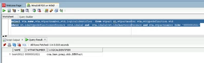

    try something  like below
    select wtm.name,wtm.wtpartnumber,wtd.logicalidentifier from wtpart wt,wtpartmaster wtm,wttypedefinition wtd
    where wt.ida2typedefinitionreference =wtd.ida2a2 and wtm.ida2a2=wt.ida3masterreference and wtm.wtpartnumber like '0000001821'

    Nice thank you!
