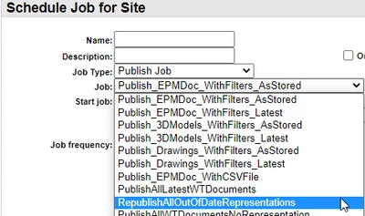

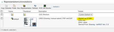

That's not an out of date CAD file but an out of date representation. It was published with latest but some dependent was updated which makes this representation out of date. There is a schedule job that you can run to republish out of date representations. To your original question, if you are looking for them in search, no, since these are representations which are not searchable. Are you looking to write a query to find these? Then it would be possible if you wrote a query to find EPMDocuments that had out of date representations and then joined that to a search.

Hereby a screenshot of what i mean..
Link an EPMDocument search to related object search.
