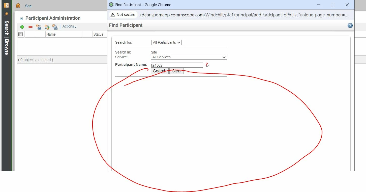

Find Participant " tab opened as "blank" whenever we hit it search (Utilities -> Participant admin)
Could you please help me out to resolve the issue with ""Find Participant " tab opened as "blank" whenever we hit it to search any from Utilities -> Participant Administration (Windchill 12.1.2)

what is the corresponding error in the MS Log

Hi @KS_9212978
I've seen this problem several times.
I guess that someone deleted user just from the Windchill,, thanks that some recent history has been affected
WTUser  and RecenUpdate.tables are affected and you would need to correct some record in database.
I would contact directly PTC support to correct the database.
An article describes consequence behavior
Various attributes, such as Modifed By, Created By, and Team Template, are not rendering the correct values on an object's Info Page in Windchill PDMLink

This also could happen if there is a misconfiguration with an adapter (like a new adapter) that is finding duplicate entries

@jbailey is right. The duplicate entries cases many troubles 😄
Usually duplicate users can not login atc.
