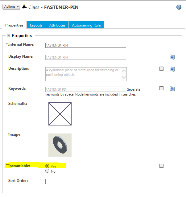

Go to Classification Administration > Manage Classifications
Click on one of the node names you would like to be able to use
Under Properties, is Instantiable set to Yes?  At least one node has to be set to Yes.

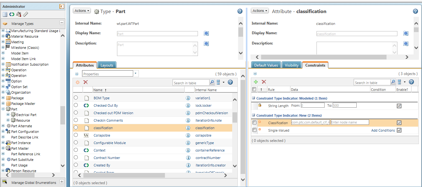

Is the classification structure empty (have you defined nodes yet?)
And are you sure you set up the binding attribute correctly using the com.ptc.csm.default_clf_namespace constraint:
http://support.ptc.com/cs/help/windchill_hc/wc110_hc/WCClassAdmin_DefineClassBindingAttr.html
Feb 9, 2016 8:15 AM UTC
I am binding attribute correctly pl check snap

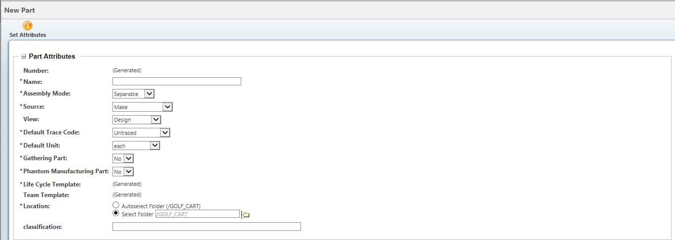

Feb 9, 2016 8:16 AM UTC
still its showing blank tab
