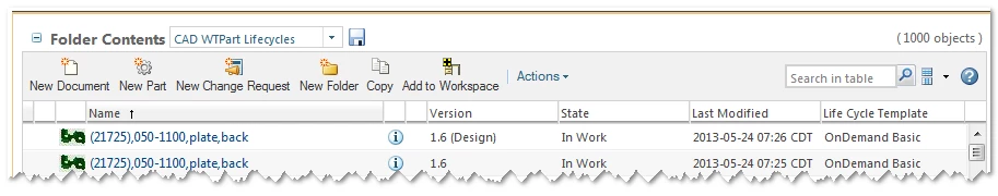

Jan 16, 2015 2:58 PM UTC
David,
We are on Windchill 10.1 now, but I think that this worked on 9.1 as well.
One way to do this is in the folder table, create a custom view and add the lifecycle column to it. Then when you display the table, each object in the current location will show it's lifecycle.
-marc
