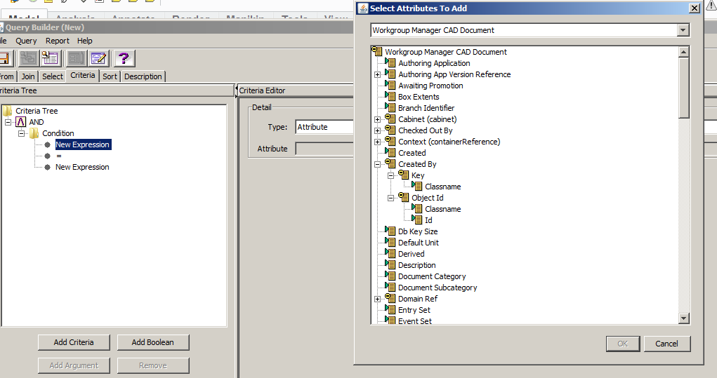

Hi Mike, I tried to use the query builder but I'm not able to form a criteria based on the attribute "Created By.Full Name".
I think I'm out of my depth here; I guess I'm naively trying to build a query to SELECT information FROM all [Workgroup Manager CAD Documents] WHERE:
Created By.Full Name = *(deleted)
questions:
1. is this not the right query to use?
2. can you use wild-cards when specifying the criteria expressions?
3. I suspect that I am trying to compare against an attribute derived from the raw data in the database (green triangle next to the attribute), and so I'm completely missing something fundamental?
22-Sapphire I
Feb 23, 2016 5:37 PM UTC
Wrestling with query builder is interesting to say the least.  For this one you've run into the limitations of what is mapped from users to the CAD Doc.  Have to add the type "User" to the first tab, then join on the 2nd tab as "Created by" or maybe "Modified by."  Then on Select, choose the user and select Full name.  Can make User Full Name a criteria and set as Parameter if needed to give the user running the report the needed filtering.
