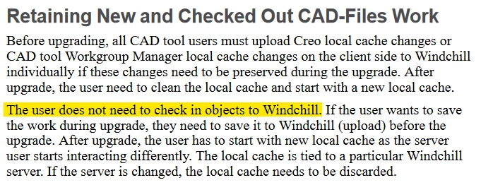

I'll chime in as well and say there should be no need to check things in or delete workspaces prior to an upgrade.  It is best practice to create a new local cache for each user (on their local computer).  For this reason, anything not uploaded will be lost (left in the old cache).  Anything that has been uploaded, even if not checked in, will already be on the server and will be fine during the upgrade.
Windchill Upgrade Guide  (page 47)
