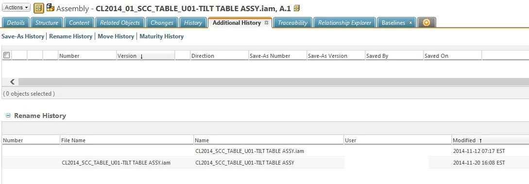

Is there a method to find or have Windchill capture the original name of a
renamed file? If we create a part, 1000307.prt with number 1000307, use it in 10
assemblies and then decide to use the vendor's name. We rename 1000307.prt to
loc-246.prt with number LOC-246. The assemblies will load loc-246 instead of
1000307, so that is good. Now management wants to see which parts used 1000307.
As far as I can tell and get from Windchill is nothing if I search on 1000307.
If I know that the new number is loc-246, I can get the where used and show the
assemblies, but still no reference exists between 1000307 and loc-246. Is there
a table in Windchill that might have this information?
November 20, 2014

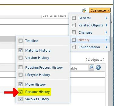

You should be able to find the original name in the Rename History table (see attachment).
Stephen Oerton
Windchill Process Specialist
November 20, 2014
We started with 10.1 and are on 10.2 M020 now. we created this tab called Additional History and added it from the customize drop down
