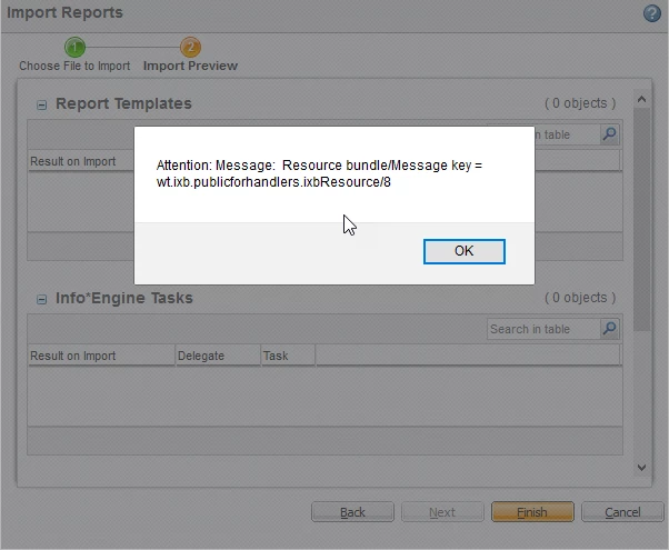

I attempted to import this file in our development system and received this error.  Any ideas?
22-Sapphire I
July 3, 2018
In the message, "ixb" refers to importing from one Windchill release to another (e.g. from 10.2 to 11.0).  Have to either export from the same release or set a property which allows cross-release imports (which still don't always work depending on the object model changes).
