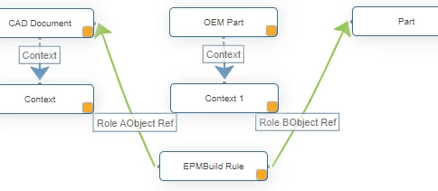

I can retrieve CAD documents via http://******/Windchill/servlet/odata/CADDocumentMgmt/CADDocuments('OR:wt.epm.EPMDocument:******')?$expand=Attachments and obtain detailed information such as PDFs. However, there's an issue as it doesn't display the relationship of the part with its WTPart. How can I find out which ID it's connected to or what information it's linked to on the WTPart? Could you assist me with this?
(In the above, ignore the 'OEM Part' table.)
You are looking for a relationship established by the EPMBuild Rule wt.epm.build.EPMBuildRule.
I don't have the OData manual open at the moment but I would be looking to expand something with a name like that.
More specifically, you will be looking for an Owner relationship.
I find this all easier to access via QueryBuilder reports, and they can be run using OData or other REST API's.

So where do I get the owner IDs from? The branchids of the DRAWING data are not displayed in the EPMBuildRule table ?

EPMBuildRule is a link between EPM Document and WTPart
If the drawing is referenced to model, then there is a different link - EPMReferenceLink.
If the drawing is linked directly to the WTPart then the link is the EPMBuildRule
