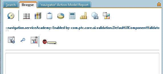

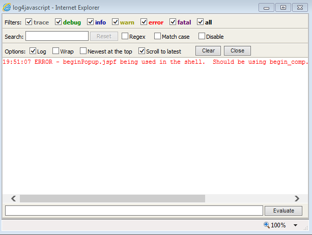

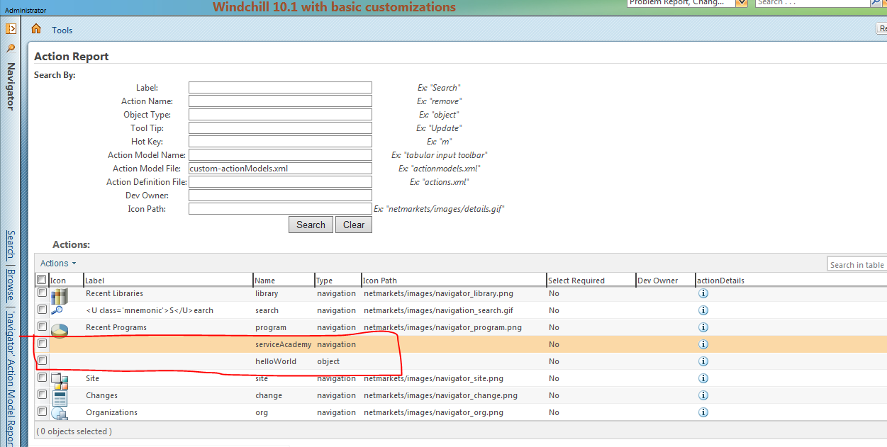

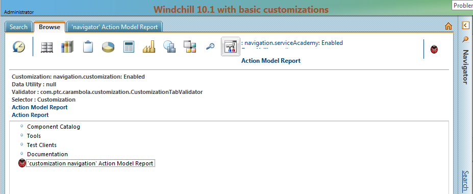

Jun 6, 2016 2:34 PM UTC
Hi Shreyas,
I added jcaDebug=1 in the url and upon clicking on navigationServiceAcademy:Enabled. I am not able to get any tab to see any second level navigator for that and moreover log4javascript window is being opened.  So please find the below two snap shots of that
But however upon clicking on Action Model Report I found that there is no label and icon.
So on basis of these screen shots can you tell me like where I had gone wrong.
As I had already posted my java code, jsp code and the code of custom-actions.xml and custom-actionsmodels.xml. I am not able to trace it like where I had gone wrong.
So I do request you to please let me know about it once.
