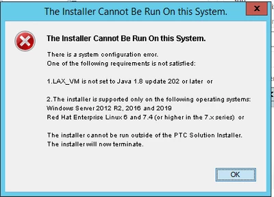

Hi This is my first time trying to install Windchill, so I am sure I my issue is a simple mistake, but I have been struggling to find out the cause and need some insight or resources that can point me in the right direction.
I am trying to install Windchill 12.0.0.
I am trying to do the install on a VM with a Windows server 2016 datacenter Evaluation (I am using a trial license, I don’t know if this matters).
I have Java 15 installed and run the setup file with the following command in powershell:
When I do this I receive the following error.
Attached are the log files associated with this error

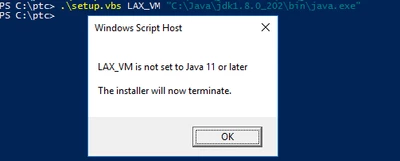

I also have java 1.8 update 202 installed.
When I run the install with this version of java I receive the following
I also get the above error when I use Jdk-11.0.7 which was recommended in the software matrix for windchill 12.0.0.0

Windchill 12 requires both Java 1.8 and 1.11.
Both need to be selected from the PSI also.
avis1-VisitorAuthor
December 3, 2020
So I have Java 1.8 update 202 installed,
how do I get the PSI to select both?

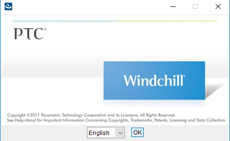

I get there error at the loading screen that appears after the language selection.
is there a way I can do it with powershell or cmd?
I feel like I'm over complicating this
