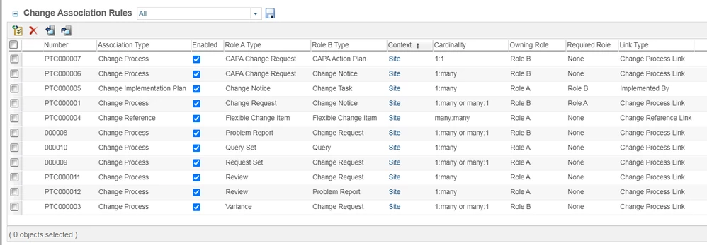

I'm stuck at question 3 @JeffZemsky , how can I find out:
"What mode is your Change Management process operating in currently?
There's several Change Association Rules ...

@rhart  - if you run the FlexibleChangeConverter tool using the report option it will tell you which version you are running.  You can find more information here
FlexibleChangeConverter Utility

Thankyou for your answer @JeffZemsky , I ran the report but I'm still not completely sure of the answer.
Current Windchill mode: Mixed
No legacy change object classes were found.
Legacy change link classes and registered FlexibleChangeLinkConverterDelegate classes:
Class: wt.change2.AddressedBy2 Delegates: wt.change2.flexible.DefaultFlexibleChangeLinkConverterDelegate
Class: wt.change2.FormalizedBy Delegates: wt.change2.flexible.DefaultFlexibleChangeLinkConverterDelegate
Change object classes and registered FlexibleChangeItemReadinessDelegate classes for action convertLinks:
Class: wt.change2.WTChangeRequest2 Delegates: [wt.change2.flexible.AdministrativeLockReadinessDelegate, wt.change2.flexible.ResolutionDateReadinessDelegate, wt.change2.flexible.WorkflowReadinessDelegate]
Class: wt.change2.WTVariance Delegates: [wt.change2.flexible.AdministrativeLockReadinessDelegate, wt.change2.flexible.ResolutionDateReadinessDelegate, wt.change2.flexible.WorkflowReadinessDelegate]
Class: com.ptc.qualitymanagement.capa.plan.CAPAActionPlan Delegates: [wt.change2.flexible.AdministrativeLockReadinessDelegate, wt.change2.flexible.ResolutionDateReadinessDelegate, wt.change2.flexible.WorkflowReadinessDelegate]
Class: com.ptc.qualitymanagement.capa.request.CAPAChangeRequest Delegates: [wt.change2.flexible.AdministrativeLockReadinessDelegate, wt.change2.flexible.ResolutionDateReadinessDelegate, wt.change2.flexible.WorkflowReadinessDelegate]
Class: wt.change2.WTChangeOrder2 Delegates: [wt.change2.flexible.AdministrativeLockReadinessDelegate, wt.change2.flexible.ResolutionDateReadinessDelegate, wt.change2.flexible.WorkflowReadinessDelegate]
Class: wt.change2.WTChangeIssue Delegates: [wt.change2.flexible.AdministrativeLockReadinessDelegate, wt.change2.flexible.ResolutionDateReadinessDelegate, wt.change2.flexible.WorkflowReadinessDelegate]
Change object classes and registered FlexibleChangeItemReadinessDelegate classes for action convertReplicatedLinks:
Class: wt.change2.WTChangeRequest2 Delegates: [wt.change2.flexible.ResolutionDateReadinessDelegate, wt.change2.flexible.WorkflowReadinessDelegate]
Class: wt.change2.WTVariance Delegates: [wt.change2.flexible.ResolutionDateReadinessDelegate, wt.change2.flexible.WorkflowReadinessDelegate]
Class: com.ptc.qualitymanagement.capa.plan.CAPAActionPlan Delegates: [wt.change2.flexible.ResolutionDateReadinessDelegate, wt.change2.flexible.WorkflowReadinessDelegate]
Class: com.ptc.qualitymanagement.capa.request.CAPAChangeRequest Delegates: [wt.change2.flexible.ResolutionDateReadinessDelegate, wt.change2.flexible.WorkflowReadinessDelegate]
Class: wt.change2.WTChangeOrder2 Delegates: [wt.change2.flexible.ResolutionDateReadinessDelegate, wt.change2.flexible.WorkflowReadinessDelegate]
Class: wt.change2.WTChangeIssue Delegates: [wt.change2.flexible.ResolutionDateReadinessDelegate, wt.change2.flexible.WorkflowReadinessDelegate]
Total number of flexible change links: 8,031
Total number of converted legacy change links: 0
Class: wt.change2.AddressedBy2 Total: 66 Count: 0 Percentage: 0%
Class: wt.change2.FormalizedBy Total: 24 Count: 0 Percentage: 0%
Total number of unconverted legacy change links: 90
Class: wt.change2.AddressedBy2 Total: 66 Count: 66 Percentage: 100%
Class: wt.change2.FormalizedBy Total: 24 Count: 24 Percentage: 100%
Total number of flexible change objects: 15,258
Class: wt.change2.WTChangeRequest2 Total: 6,868 Count: 6,799 Percentage: 98.99%
Class: wt.change2.WTVariance Total: 0 Count: 0 Percentage: 0%
Class: com.ptc.qualitymanagement.capa.plan.CAPAActionPlan Total: 6 Count: 6 Percentage: 100%
Class: com.ptc.qualitymanagement.capa.request.CAPAChangeRequest Total: 6 Count: 6 Percentage: 100%
Class: wt.change2.WTChangeOrder2 Total: 6,436 Count: 6,367 Percentage: 98.92%
Class: wt.change2.WTChangeIssue Total: 2,111 Count: 2,080 Percentage: 98.53%
Total number of local legacy change objects eligible for conversion: 0
Class: wt.change2.WTChangeRequest2 Total: 6,868 Count: 0 Percentage: 0%
Class: com.ptc.qualitymanagement.capa.plan.CAPAActionPlan Total: 6 Count: 0 Percentage: 0%
Class: com.ptc.qualitymanagement.capa.request.CAPAChangeRequest Total: 6 Count: 0 Percentage: 0%
Class: wt.change2.WTChangeOrder2 Total: 6,436 Count: 0 Percentage: 0%
Class: wt.change2.WTChangeIssue Total: 2,111 Count: 0 Percentage: 0%
Total number of administratively locked legacy change objects eligible for conversion: 0
Total number of local legacy change objects not eligible for conversion: 169
Class: wt.change2.WTChangeRequest2 Total: 6,868 Count: 69 Percentage: 1%
Class: wt.change2.WTChangeOrder2 Total: 6,436 Count: 69 Percentage: 1.07%
Class: wt.change2.WTChangeIssue Total: 2,111 Count: 31 Percentage: 1.46%
Total number of administratively locked legacy change objects not eligible for conversion: 0
No legacy change objects eligible for conversion have been found. Run the convertLinks action.
