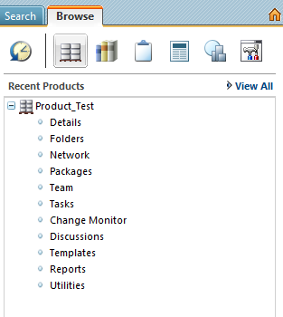

Hello Luar,
Once you click on Team option you need to add yourself to the role Product manger
By the way or you an end user or an administrator ?

Hello Luar,
