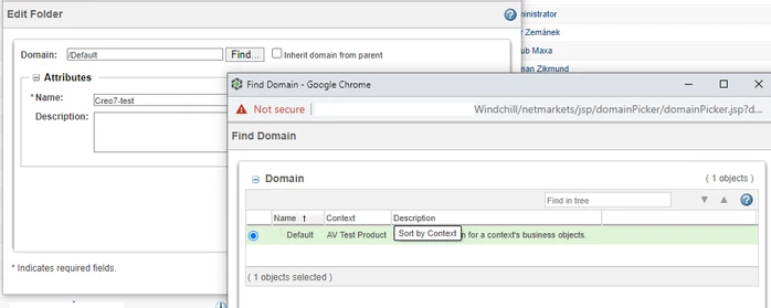

Hello Everyone,
We have folder domains created in each product to provide access to respective groups in phase wise.We change the folder domain as and when product is matured.We have this 100+ products and each product has folder domains with ACLS(basically all products has same ACL s for folder domains).I am trying to remove this folder domains at product level and use shared team to control ACLS,I am able to assign shared Team ACLs to Product,but the domains created under shared team is not getting populated in the product,it seems folder domains is restricted to thier respective context!!Does anyone know how to use folder domains created at org level to all container(similar to how we use ACLS created at ORG and use them in context level).thoughts??
Thank you

Hi @Srinivas_256
I guess that folder domain created on the org level can be used just for folders on the org level.
Product context domain level can be used only on the folder in the specific context.
So You need to define ACL on each domain assigned to the folder in each context.

Nov 20, 2023 11:02 AM UTC
Thanks Petr.
I checked with PTC on this and they confirmed same as above you mentioned.
Thank you for you response on this.
