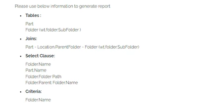

HI, I am looking for a particular info in the database tables to build a report. Each part in windchill PDM has a location (Folder info) and I need to get that in my report. I gone through most of the tables in the PDMlink database, but could not find correct table.

    Take a look at this article
    Report to list WTParts from folder

    Thank you for your response. I actually connected the windchill database to powerbi to take reports as I have a particular requirement to do that in powerbi.
    so, I am looking for this folder or location info in the database tables.
    MarcoTosin
    Feb 21, 2024 7:19 AM UTC
    Have you read the article?
    The name of the table is written there
