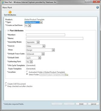

Force End Item = Yes?
I'm on 10.1 M020 and I'm unable to force the End Item attribute on a WTPart soft type to "Yes" either through the OIR, Default Values tab, or both. Has anyone been able to do this? It always remains at "No" no matter what I do.

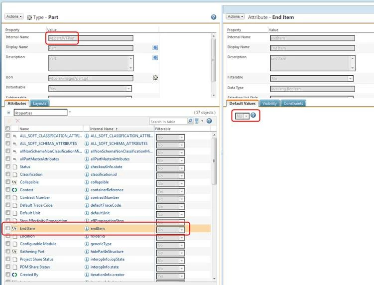

Pat,
Try using the Type and Attribute Manager and changing the default value on the Part object.

May 31, 2013 4:27 PM UTC
Yep I put that in my original email (Default Values tab). But for some reason it's not working.

May 31, 2013 5:00 PM UTC
Yeah just checked a 10.1 and 9.1 instance and neither specify endItem OOTB.
Checkout under codebase/com/ptc/core/rule/server/delegate/init/RuleConfigurableTypeAttribute.properties.xconf

Jun 3, 2013 11:05 AM UTC
You’re right David, endItem is not in this file so I assume it can’t be configured in the OIR. So can “any” attribute be defined here to be configured by the OIR? For example it would be really nice to know the WTPart View in the OIR to configure numbering for Design view parts differently than Manufacturing view parts.
<property name="wt.part.WTPart" default="number,name,lifeCycle,lifeCycle.id,teamTemplate,teamTemplate.id,folder.id,organization.id"/">

Jun 4, 2013 5:05 PM UTC
In theory any persisted property should be allowed. Non persistables maybe if used in conditionals. Java code required for certain attributes like setting part view or quantity to default or lock to each...buy...make etc. In those cases you may need to know the java class type persisted so your custom algorithm may return an instance of that type during rule execution. I typically look at these in the database for pointers. Using a customized resource bundle key I.e. Setting a default value other then make or buy etc or for a locked custom IBA etc.
