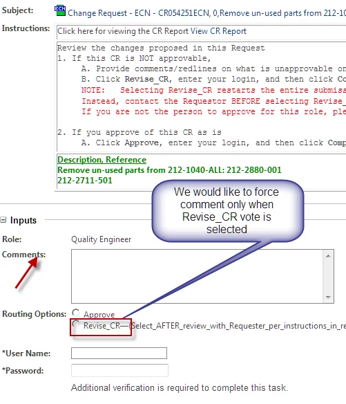

We have so many exciting workflow email threads lately, I would like to throw this one out there as well...
This is a very valid use case and asked many times in Alcon. I hope somebody has figured this out already.
We would like to our users to put comments when they are revising (for example). When they select other vote Approve in the below screen shot, it should just let it go as is and completes the task. So the criteria is ..
1) Check for the Voting option (Revise_CR)
2) Look at the Comment Attribute and force it to be filled if empty
[cid:image001.png@01CF5316.70B54EB0]

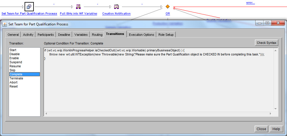

BenPerry
Jan 4, 2017 1:58 AM UTC
Archit Todi‌,
Please confirm that your java code is placed in the Complete transition of your workflow task.  Do you have a screenshot?
Below is an example from one of my workflows.  This is actually a workflow that is routed on a WTDocument PBO.  One of the next steps is a Set State robot.  So I want to make sure the WTDocument PBO is checked in before completing the workflow task.  That is what the code does.  If the WTDocument is checked out, then when the user clicks on the Complete Task button, it will throw an error and the task cannot be completed until the document is checked in.
Jun 4, 2014 6:48 PM UTC
Can you show your workflow and where the code is at?
[cid:image001.gif@01CF7046.C96AB930]
