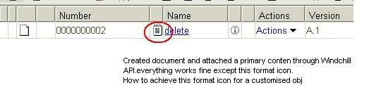

Hi all,
createdWT document and attached Priamary using Windchill API.
document is created and primary contentis also attached on it.
but in the table view,the format icon is not displaying.
Regards
Gangadharan.N
January 24, 2011
Gangadharan,
The icon shown by PDMLINK dependson the extension of theprimary file.
You can edit the assigned values with the following java class :
java wt.content.DataFormatUtil
with -list, you obtain a list of existing associations,
with -add, you can add new extensions and assign names and icons to them.
HTH,
Vincent

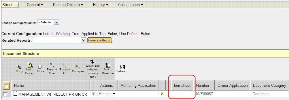

March 1, 2011
Hi all,
I want to display the icon of a document in documents structure but I'm only able to display the column, not the icon. Does anybody know how to show it?
I've tried modifying /codebase/templates/enterprise/doc/DocumentStructureBrowser_en_US.html with the following lines, but no success:
tableService action=setCellComponent NAME=formatIcon CELLCOMPONENT=com.ptc.windchill.enterprise.part.structure.FormatIconCellComponent
Felipe</h3>
