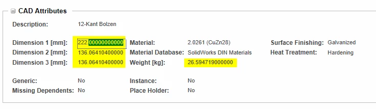

per default our Windchill 11.0 M030 displays real number attributes on the information page with 12 digits after the comma like seen on the attached screenshot.
Is there a way to format the numbers to a given precision?
Many thanks in advance.

Thanks for the link to the article.
Unfortunately it says:
"Real value attributes on EPMDocuments and related WTParts are always displayed with full precision (up to 14 significant digits)"
so what I want to achieve seems not be supported in Windchill 11.0....

It is that way in 10.1 M050 as well.  I thought I remember in past versions that it wasn't this way.
