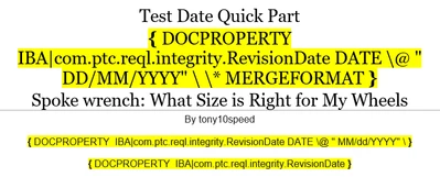

Could someone provide the EXACT syntax how this is accomplished? Something like this maybe
{DOCPROPERTY IBA|APPROVAL_DATE \@ "YYYY-MM-dd" \* MERGEFORMAT}

However have a look a this call it explains why you may be getting different results.
https://www.ptc.com/en/support/article/cs132614

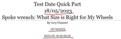

In the screen grab below you can see the 3 different versions on one page.
And how I formatted them.

I didn't reply anything to "it would be more useful if you told us your version..." as it seemed like in this case it's of no relevance and I had a case opened with technical support which sort of proved this. First of all, the effort put to test this was remarkable and beyond expectation, big hand to the engineer involved.
However, the question about version is interesting as testing showed the behavior is different depending on the version used, but also not consistent..! So, yes, when making a question it sort of would be useful, but in the end... how do you plan and prepare solutions with this sort of reliability.
So, anyone implementing similar: Play around and test a lot, but be prepared that someday (upgrade / update) it just does not do the job anymore.
