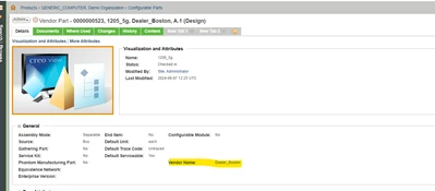

From a Supplier Part page, how do I tell who supplier is?
Version: Windchill 12.0
Use Case: I know I can see parts linked to suppliers (mfg or vendors) from the supplier page but what about from a part page? I am looking at search results or a part details page. Where is the supplier listed?
Description:
This might be a duh question but I have this case:
3 Vendor parts but indication which is from which vendor. I could not see it on the details page. I think I need to add and attribute to the details page or create an alias attribute. Am I missing something?

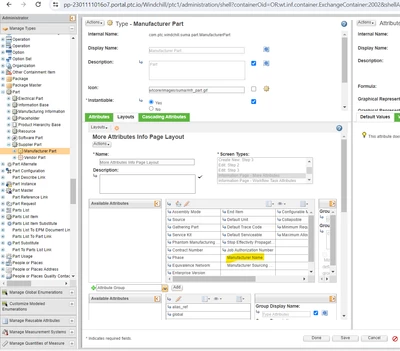

not sure I fully inderdatnd this you can add manufacturer name/Vendor name  to the layout :

avillanueva
23-Emerald II
Jun 7, 2024 1:09 PM UTC
Thanks, I was looking at at Supplier Part. Works now. Next is to break inheritance from WTPart since there are attributes I do not want to show at this level.
