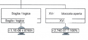

I'm trying the demo version of PTC Windchill FTA. I've found this example of fault tree:
which calculation type and model has been used?
I think that tau:8760 is the time between test, but what T=100% stands for?
How can I display the input data like in the picture?
