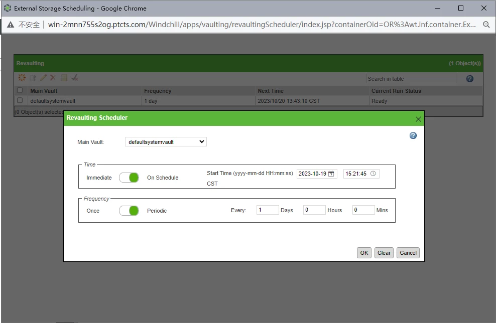

I am using Windchill PDMLink Release 12.0 and Datecode with CPS 12.0.1.0
We are planning to perform a revaulting operation to move approximately 820GB of Oracle BLOB vault data to the Master Vault. I would like to request support for revaulting work.

Best answer by Rocket_Max
Hello @YH_10333800

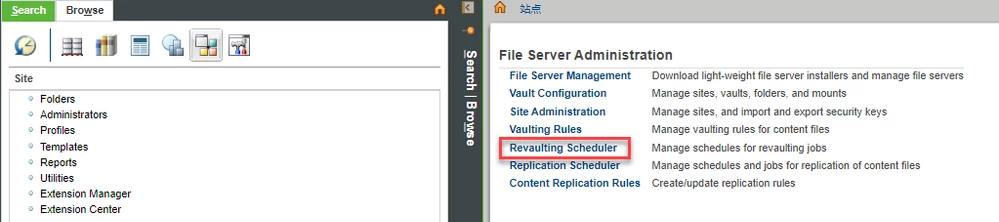

  1. Make sure that Windchill has already configured vault
  2. Execute Revaulting action:
    1. Schedule a one time, immediate revault job for the target vault in step above
    2. Site > Utilities > File Server Administrator > Revaulting Scheduler
Share a few screenshots of my environment(12.1)
I think a more thought-provoking question is "Why did the data enter the DB instead of the vault“, Because this can cause E-down, it is necessary to carefully investigate the vault configuration
