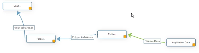

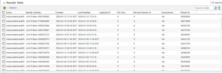

I am in the file stage of my vault move and clean up. There are 0 files in the remaining folders but a Query Builder report show 50 files remaining.
When I executed a vault WContent verification check and everything comes back clear. No missing files. huh? I created a new report to check the FVItems against ApplicationData and it shows that there is no ApplicationData tied to these FVItems at all. Bad data? I would thing so. All show 0 bytes in the DB too. Now this article says that the CommonScheduleQueue should clear those no worries. Except that I waited a day and nothing. These also have existed for many weeks and odd that the timestamps show recent.  I think my only recourse is to remove the offending lines records right? Is there any other thing that can be tied to these?

Not quite. I can see that the job ran but there was no result. Odd. I ended up manually removing the 50 lines after backing them up. The remaining vault folders were remove and then the vault was removed so looks like I am all good. I will have to further play with this task since it does not appear to be functioning. One remaining question I have is why is this task running in the commonSchedlingQueue (executes on start up I can confirm) but not in the PurgeUnreferencedFvItemQueue? Perhaps its the age of my system when PTC ditched the queue in favor of the common one. Hmm. Anyway moving on...

Query ApplicationData for associations to the mainvault.  This article shows the relationships for building the query.
https://www.ptc.com/en/support/article/CS121641

I created this QueryBuilder report to get the data on the 50 FVITEMS:
ApplicationData to FVItem is outer joined so if the FVItem does not appear in the ApplicationData table, it will show nulls. I am also looking specifically at the the vault I am trying to remove which reports to have only 50 items matching this report. Notice AppData ID is null indicating there is no ApplicationData object referencing this FVItem.  Junk data?
