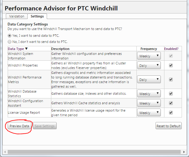

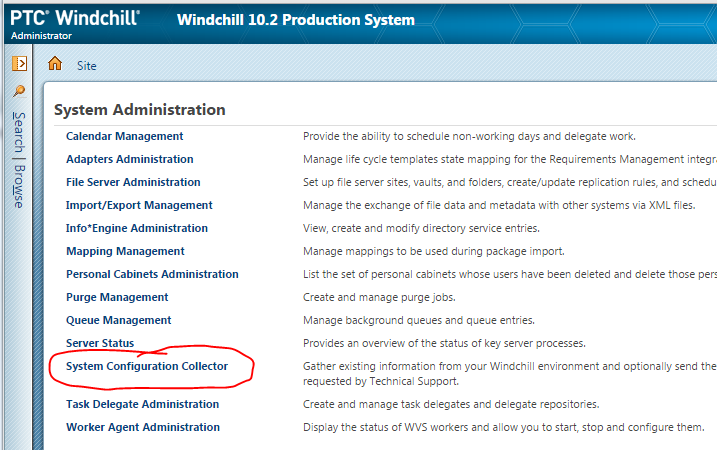

You can preview the data without actually sending anything.  This is from Site --> Utilities:

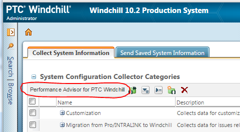

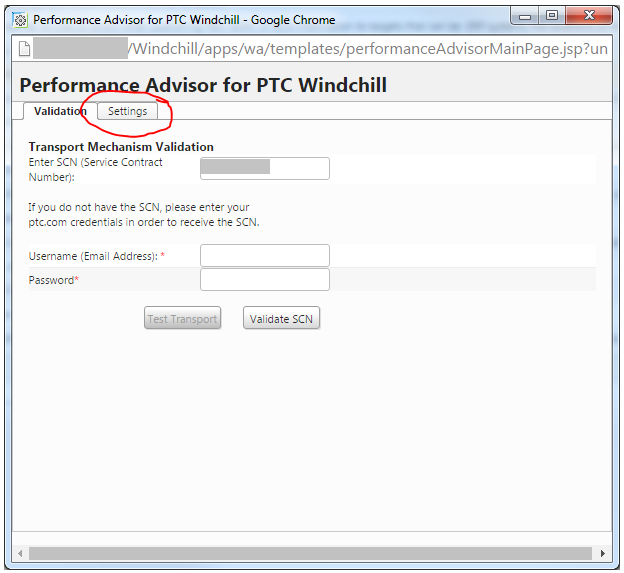

TomU
Jun 29, 2016 2:25 PM UTC
This is from 10.2 M030.  (Of course you do have to install the WPA patch first...)
