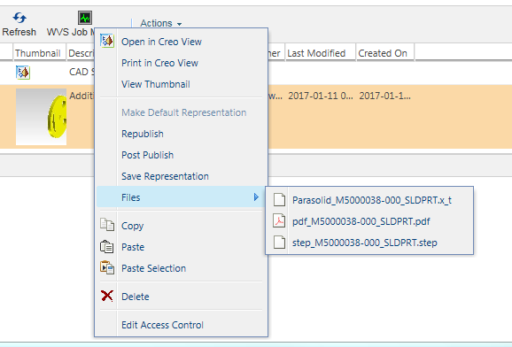

I have been trying to do something similar to this.  Our business process depends on the output of STEP and parasolid files from our model files.  I am trying to make them more accessible by putting them into their own WTDocument during the publish phase.  I have written the following publishing rule xml.  The file passes validation and loads into the WC system.  On publish it is creating the Step and Parasolid and attaching them as representations.  Id does not seem to be performing the post-publishing operations and creating the WTDocument.  I am not seeing any error/log information of failure.  Could someone please look at the XML and see if I am missing a trigger statement somewhere?  Thank you.

UPDATE:
     I added a manual option to run the post publish and I am seeing an error that says
Post Publishing Succeeded with Warnings
Warning: No additional files match the regular expression in the post publish parameter set

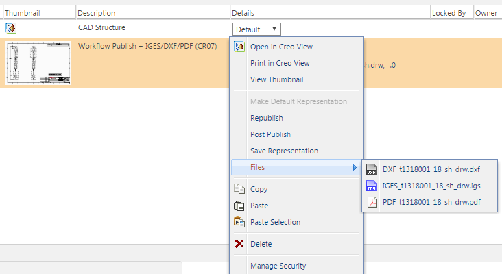

You might try removing the "param-set" piece and just verify that the additional files are generated correctly (and attached to the primary representation.)  Once you're sure that's working you can fix the post-publish delegate.
Jan 11, 2017 3:35 PM UTC
sorry should have been more clear.  I started from that direction and the files are being created.  Even with the above code I can go to the view you depict in your image and I see the relevant files.  Then I click Post Publish and get the error.
