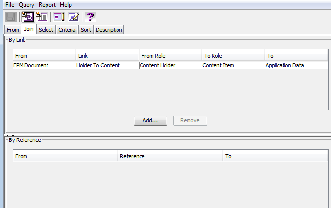

Hi all,
Is there a way or is it possible to create a report that will generate who checkin/checkout the documents? Or how many times that the documents checked in/ checked out?

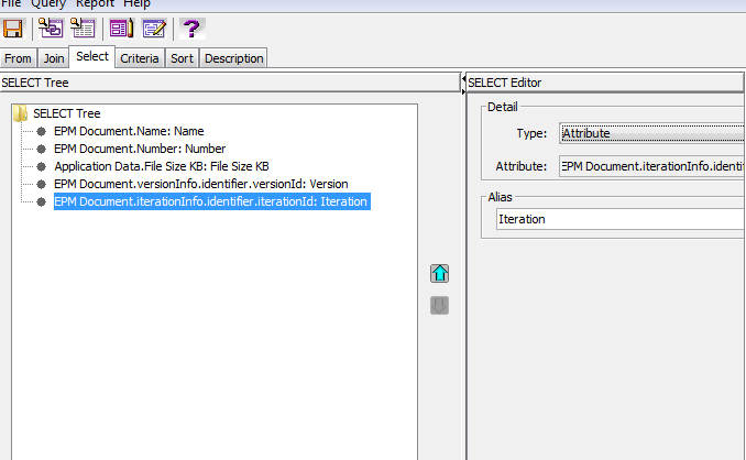

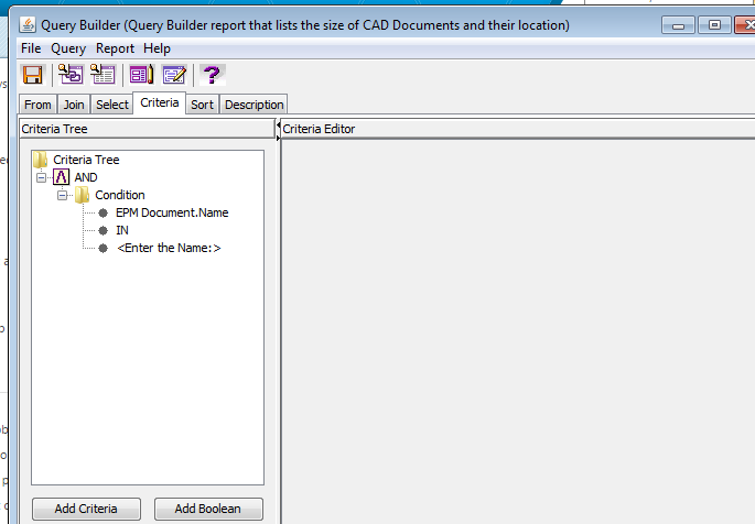

Luar1-VisitorAuthor
Mar 25, 2015 8:22 AM UTC
I want to generate report with a date range but I don't know what attribute that I'm going to use. To generate a report that shows all of the drawings within the specific date range.
The FF. is the attribute that I used but there is no date range it only just show all the Report that lists the size of CAD Documents.
Bset Regards,
Luar
23-Emerald II
Apr 4, 2015 12:43 AM UTC
This article provides an example of how to do a date range in Query Builder:
http://support.ptc.com/appserver/cs/view/solution.jsp?n=CS153996
