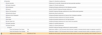

There is a setting in Windchill Preference Management that defines the initial revision from SolidWorks custom properties:

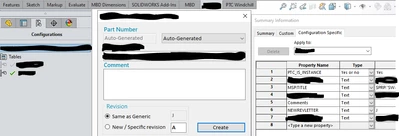

On top of that, we have a custom new configuration macro in Solidworks that creates new configurations with an option to define the revision (it just creates the appropriate custom property):
We also have a custom SolidWorks Add-in. One of the things that this add-in does - it deletes this custom property when the new instance is created in Windchill (so things won't get messed up if you do a save-as).
