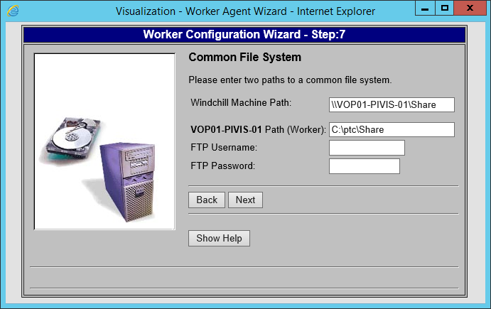

Dec 12, 2016 10:38 AM UTC
Instead of using FTP, you can use a shared folder.
