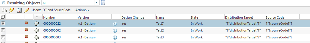

Get IBA value of Distribution Target in Resulting Objects column
I want to add one custom column name distribution target. How can I read the values of Distribtuion Target name from WTParts details page and put it into the custom column?
Any Idea..?

Thanks for your solution. This is to update distribution target of all the parts present in the table. But in my case I have toPTC_Case.PNG update , only for those parts, I have selected . How can I check which parts I have selected in the resulting objects table??
Sakil
